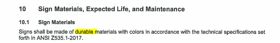

Dumb question: Do the code required labels need to be listed or printed on listed material, or printed on listed material only with the material manufacturer's printer? Or is any durable outdoor label material acceptable?
