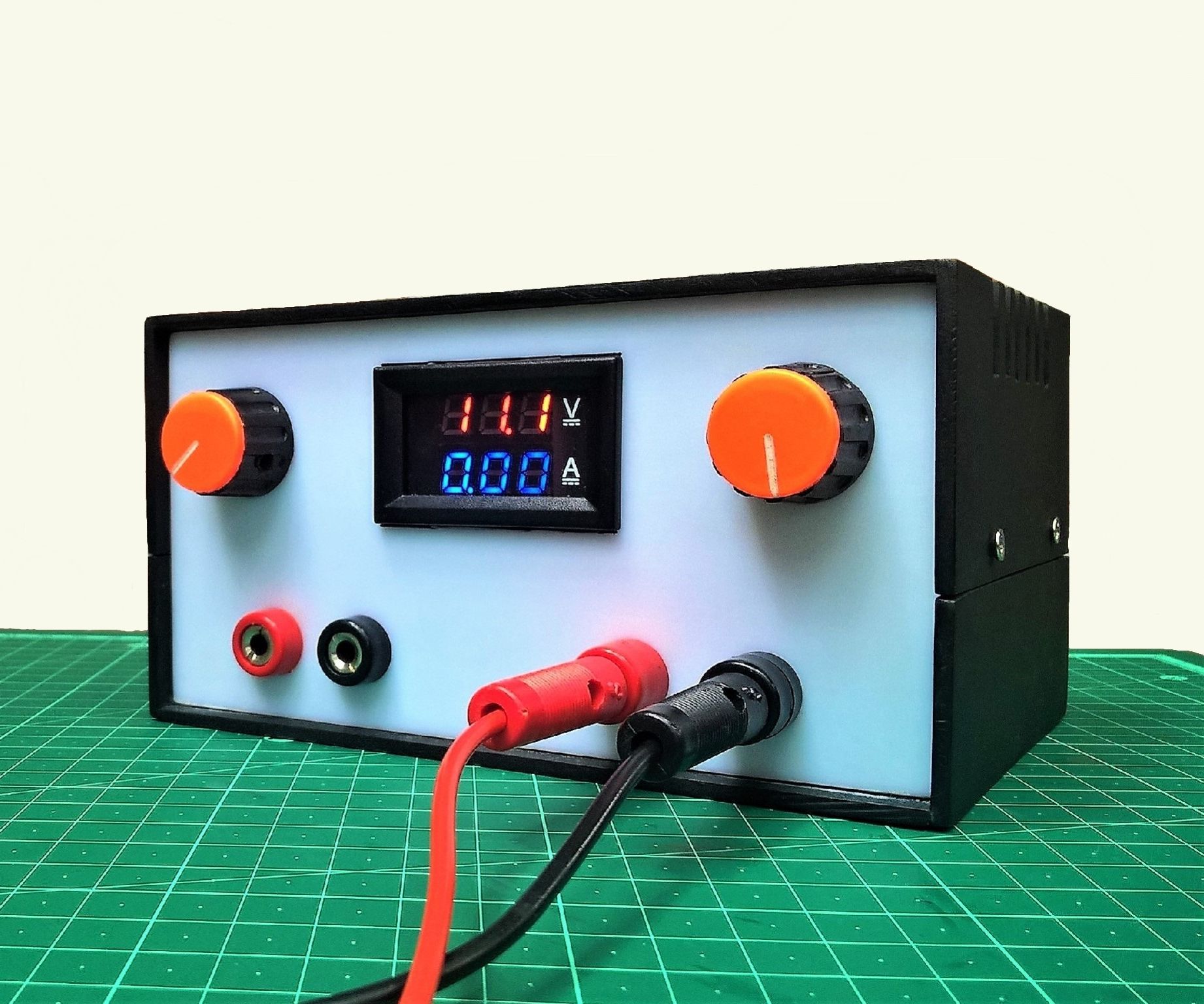

Faithfully sitting on my work bench is a benchtop variable power supply, 0-10a 0-32volts. 120vac input.
My question is: Does such a unit exist like this that has a 12vdc input?
No, I'm not looking for one of those 1.5/3/4.5/6/9/12v adapters you can buy on Amazon for 8 bucks. I want a unit just like shown in the photo, but with a 12vdc input.

When you want to increase a DC input to a higher DC level, it's called a "boost converter". The little one shown above is only 80W max, so at 30V that is 2.7A, the one you showed at the top is 10A @ 30VDC. Do you NEED 10A? And do you NEED 30VDC, or are you after something more common like 24VDC?
I need 30v as I need 24 and 28v. I also need at least 5a.
The low cost board level switching supplies with the LTC3780 IC typically have a spec of 50mV output voltage ripple. Is that adequate for your application? If not then you may need to add a larger output capacitor or LC filtering, or add a LDO linear regulator on the output of the switching supply.
