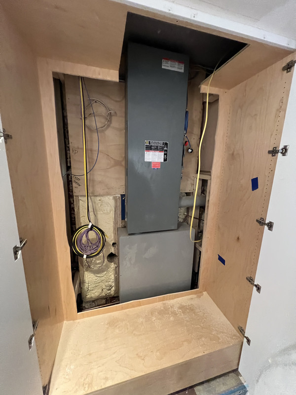

Does this installation look compliant?
designer82
Boston
It's the main fused service disconnect for a large single family residential project.
Looks like they put the main disc. sw. inside some kind of cabinet. I think the main concern here is 110.26(3) Height of working space, which says 6.5' or height of the equip., whichever is greater. This doesn't look like 6.5' to me.
Section 110.26(A) does have this verbiage "likely to require examination, adjustment, servicing, or maintenance while energized". Not sure if this disc. sw. falls within this requirement.
Here is the photo:
Does not meet the dedicated equipment space nor the required working space.
Thank you Infinity. The dedicated equipment space applies only to "switchboards, switchgear, panelboards, MCC's" so this disc. sw. doesn't fall within those requirements.
But yes, the working space Sec. 110.26(3) is the problem unless it's 6.5' from that platform to the celling. (doubt it)
fyi, they confirmed that height is over 6.5'. I believe this install is compliant.
From the photo it's looks like it is not code compliant but it is hard to tell without dimensions. For one the base at the bottom is in the working space. The cut out at the top would need to be a minimum of 30" wide and 36" deep which it might be.

That's an allowable exception in 110.26 for residential, 200A or less, basically to allow for basements that are not full height.

The fact that it is a FUSED disconnect makes it qualify, according to every AHJ I have dealt with on this.
Is that cabinet 36" from the front of the disconnect to the inside of the cabinet door?
Even if that's true, I don't think it meets the working height requirements, i.e. clear to the grade.
