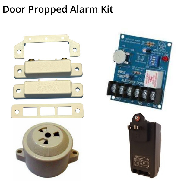

Customer has an apartment building with three exterior doors (but don't need them inter-connected) where some tenants prop the exterior doors with rocks and bottles so people without keys can get in. They want a loud alarm to sound after a period of one to five minutes (preferably adjustable to see what time works best.)
The hope is that the alarm is loud enough that the tenants who understand the need for security will over-ride those who keep propping the doors open. They also need them to be powered in a way that can not be easily defeated by simply unplugging the power supply with a stick or ladder, so hard-wiring them is a plus.
There is already always-on power near each door for a light and egress lighting, so that's not an issue. I thought a battery backup might be useful in case someone finds a way to disable the power, causing the alarm to sound immediately, but wouldn't want them sounding continuously in case of a power outage.
Any suggestions or advice is welcome.
use a door contact switch connected to a timing relay that powers a horn signal. A recessed contact in the top of the door would be ideal if you have access to the wall cavity for fishing the wire down. If surface-mount use the type with an armored cable lead.
You can group all the components together in a sealed enclosure. I'd probably skip the battery part.

Is there a tamper-resistant packaged unit made with a loud horn or siren in it?
There is factory assembled devices that do exactly that, but as others have said, a magnetic switch or contact tied to an on delay relay and horn of desired db. It will automatically reset after the door is closed.
I'm interested in the factory-assembled versions, whether to buy it or copy them.
A professional-looking system in a metal enclosure is better than a plastic fridge alarm.
Do you have any info on them, please?
That looks great, except we would need a tamper resistant enclosure.
That looks too easy to break. More like a commercial fire alarm horn.

These need to be loud enough that people in their apartments will complain to whomever props a door open.
I didn’t realize Detex made door-prop alarms. I’ve installed a couple hundred at least of the standard Detex door alarms over the years in all the restaurants i built and they are solid devices. I just looked at their website, and they also offer a hard-wired version.
I’m sure this surface-mount door prop alarm is just like the regular door alarm and made of cast aluminum. With the hard-wired alarms, if someone opens the cover to try and disable it, the alarm will sound.
I can vouch for them and would say to just buy the Detex. Oh and they are ear-piercing loud.
