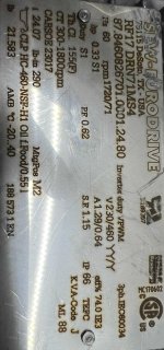

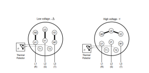

I wired in a drum motor in the factory I work at. The wiring diagram was on the cover plate for the motor termination box. I followed the wiring diagram for high voltage exactly:
The motor turned at a very low RPM, did not turn smoothly and overloaded the VFD in less than a minute.

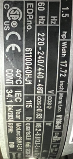

There is a different belt conveyor right next to the one I am working on with the same model drum motor. It is wired according to the following high voltage wiring diagram and works:
After contacting the service rep, I tried the wiring the NEW non working motor like the one that is working. The motor did not turn at all.
