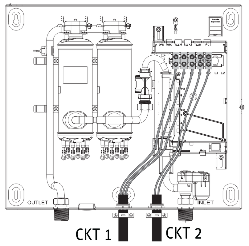

I have a dual circuit water heater. Please see vendor's wiring diagram in link below.
I'm not sure how to do the local disconnect. 2 different disconnects (one for each circuit) or 1 disconnect that is like double pole, double throw type of deal?

If I’m understanding your wiring diagram correctly, it appears there is a 240V circuit, and a 120/240, so a 2 pole disconnect wouldn’t work.
You’ll need two disconnects grouped together and labeled.

One power source shows L1, L2 & EGC. The second power source just shows L1 & L2
2 disconnects can be used or a feeder can be ran to a small 4 circuit load center.

I like the single feeder, local 4 circuit load center idea. Cost effective.
Do you know if there's a requirement for a handle tie (for the two double pole breakers) for such an application?
Handle tie is not required but 225.30 has requirements for multiple circuits to one appliance.

What you have fits description of a MWBC even though larger than most. That would require meeting 210.4(B) that disconnects all ungrounded conductors. Had one that required 120A from 3- 40A 2 pole breakers, had to handle tie all 3. Breakers within sight of heater so used as disconnect.

Look at the definition of a multi-wire circuit. Two, 2-wire circuits does not meet the definition.
Even if there were multiple MWBC's feeding the equipment the simultaneous disconnect rule for MWBC's would only apply to each set of circuits sharing a neutral.
So I guess the inspector that said I needed a handle tie was wrong.
Looked at the definition and I missed that it said "AND" a neutral.
