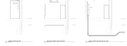

A Alwayslearningelec Senior Member Location NJ Occupation Estimator Jun 3, 2025 #1 When running underground and turning up into building/gear do you usually "clear"(run beneath it) the foundation wall so there is no penetration/link seal etc. needed? I know your still going through slab obviously. Thanks
infinity Moderator Staff member Location New Jersey Occupation Journeyman Electrician Jun 3, 2025 #2 We would typically go through the wall with link seals on the inside. The water proofer would seal the conduits on the outside.
