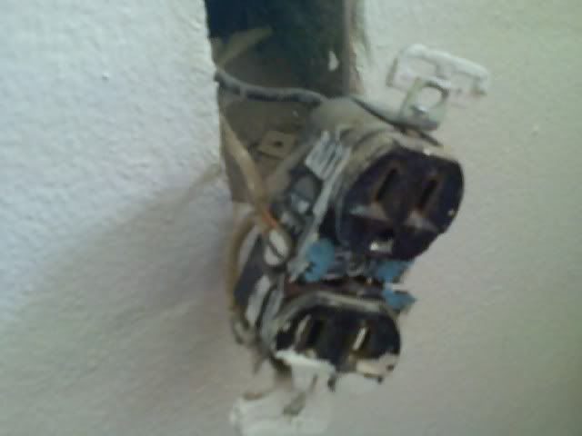

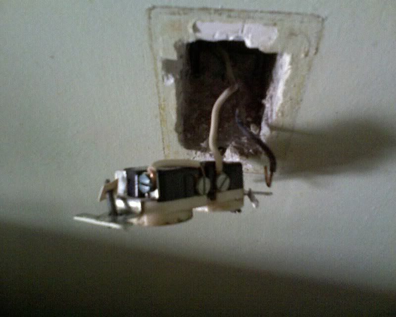

During a recent renovation....
mjaenke
I found this - all through the house. This particular one was for the gas stove. Thought you guys would like it.
crossman said:
So who knows what the major safety issue of that is?
The equipment grounding terminal is now a current carrying conductor. If you were to touch two grounded objects with that configuration you would be part of a parallel path for neutral current.
I found this configuration on a brand new home one time.:mad:
Chris
Yep... but as long as all the neutral connections/conductors are secure and low Z, there isn't all that much chance of a bad shock. However, lift a neutral or have a loose or corroded high Z neutral connection and all of a sudden the equipment grounds have become hot, including any grounded equipment plugged into the outlet.
i've had home inspectors request that be done "so it'll show up grounded on the tester." (head explosion in 5. . . ..4. . . . .3. . . . . . .)

Jim W in Tampa said:
It was a cheap illegal way to make it look like a grounded receptacle.Ihope the guy that did it gets to pay for the fix.That kind of work is only done by hacks.
