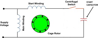

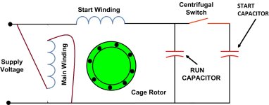

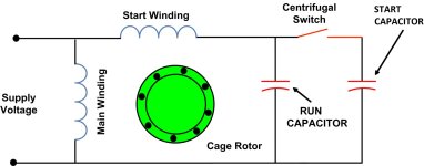

It is most likely this capacitor start/ capacitor run
But it could also be this with just a capacitor start
Not really much to either circuit
And to reverse rotation you just swap leads on the main winding or the start, whatever is easier
