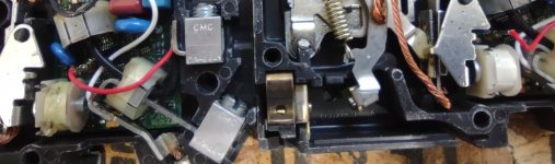

Early 80s gfi breaker internals
If that is the test resistor it seems like it should be brown/blue/white/red (16.9k). Looks like it is brown/blue/white/orange (169k)
I'd Already tossed it in the trash bin before I saw the posts asking for an ohm reading. Looking at the picture in my phone it shows as
Black blue grey orange gold brown. Which is a 68k ohm. I'm not sure why that's different than a modern one at 16k. But in the past gfis just needed to be more sensitive than 5ma of leakage current so 1.7ma would be allowed. Now it's 5ma+-1 so it wouldn't fly now obviously. A 16k one would work for a gfi of that modern tolerance pushing about 7ma.
It will always have to be sized to flow at least 6 mA at 85% of the rated voltage per UL 943.
