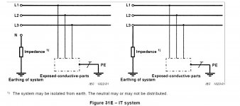

If I may:
"A 3ph system supplying a load via a 3-wire cable with no EGC. Can I use earth alone for grounding?
"Can I use 1ph and use the third wire as the EGC and provide the load with a 1ph-to-3ph converter?"
If we look at SANS 10142-1- the South Africa national electric code -we see it is close to British Standard BS 7671-in my opinion-and then it is close to IEC 60364-1. In the last standard, chapter 312.2 Types of system earthing, 312.2.3 IT system. The IT power system has all live parts isolated from earth or one point connected to earth through an impedance, the exposed-conductive-parts of the electrical installation being earthed independently or collectively or to the earthing of the system. However, one has to follow the further details in IEC 60364-4-41.
