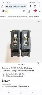

I'm installing an Eaton CHSPT2ULTRA a Type 2 SPD. It has 12 wire pigtails.
Eaton specifies use of 50A breaker.
Breaker is a Siemens Q250U and the terminals are for 8 wire.
I can use some short 8 wire to hook it up with wire nuts.
Is that an acceptable solution?
