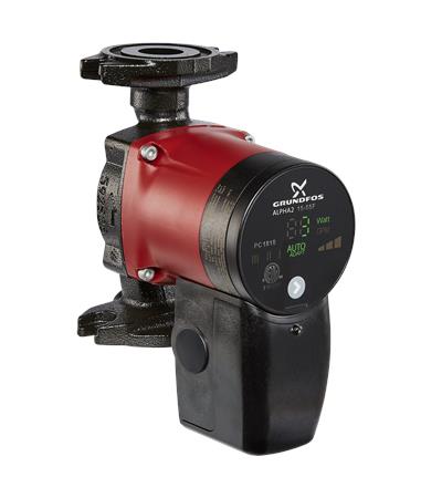

I had my boiler replaced a a few months ago and the two new circulators are Grundfos Alpha ECM units.
The autoadapt mode seems to work very well for determining a good operating point for the system.
They're significantly more efficient and quieter than the Bell & Gossett pumps they replaced.
