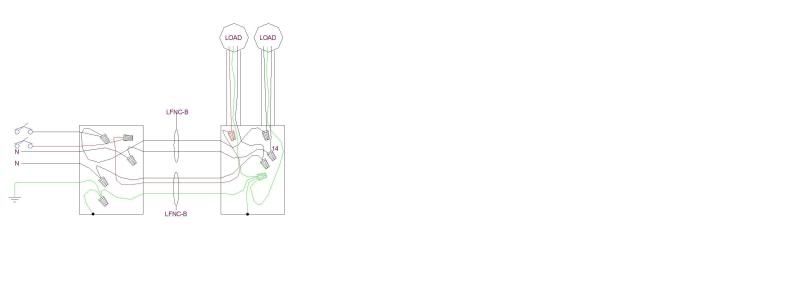

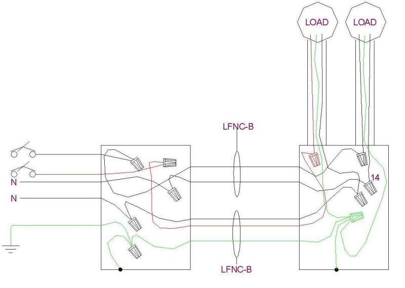

Here's a pic of the ciruit in question. How do I prove that the second raceway NEEDS an EGC
Nice picture. It explains everything.
The top conduit contains circuit conductors that supply the right hand load. That load needs an EGC, in order to protect its user from a ground fault. I agree with you that, since the right hand load has a connection within the junction box to the EGC that runs in the lower conduit, it will have the necessary protection. However, 300.3(B) still requires the EGC serving the right hand load to be within the top conduit, as it requires the EGC to be in the same conduit as the circuit conductors, wherever those circuit conductors are routed.
Are you asking why 300.3(B) has that requirement? My best guess is that someday they may eliminate the left hand load, and remove the lower conduit. If the upper conduit does not have its own EGC, then it will be left without protection.

Because the equipment on the right is connected by permanent wiring methods, Section 250.110 (2005) requires it to be grounded. One of the methods permitted for grounding this equipment is by providing a connection to an equipment grounding conductor routed with the circuit conductors per 250.134(B). The raceway from the panelboard to the junction box, for the load on the right side of the picture, does not include an equipment grounding conductor and is in violation of 250.134.
