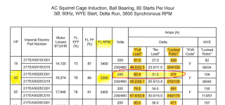

We have a single phase 200A service for the house panel which feed the 20HP 208V 3ph elevator with 65.4 FLA and 311 LRA. We feed the elevator through the 50HP phase converter (American Rotary AUL - 50) and 30KVA 240V - 208V 3ph transformer. See below single line diagram. The phase converter is sized 2.5 times the motor horsepower for the inrush starting current. The transformer is sized to 125% of the elevator full load amps.
However during testing, the elevator company guy states the voltage drop at the elevator starter during the starting is too large and not acceptable. I think both the converter and transformer sizing are good. Any ideas and solutions?
