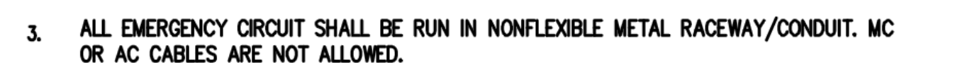

The designers are using older terminology, up through the 2011 cycle it was spelled out using their term.
517.30(B)(2)
(2) Emergency Systems. The emergency system shall be
limited to circuits essential to life safety and critical patient
care. These are designated the life safety branch and the
critical branch. [99:4.4.2.2.1.1]
