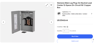

I’ve never seen a meter/MLO combo panel. Do they even exist?

They were commonly used for houses. I think they were 12/24 slots - They'd put the entire house branch circuits and a dryer fed to a sub panel on a 90A breaker with #2AL. Then the stove, AC and range outside in the main lug panel (Or something similar)
If they had 5 full size 2 pole breakers, sometimes a unscrupulous person might put 4 singles in the last two slots making it a violation of the six disconnect rule.

I have never seen a meter combo with 12/24 loadcenter. (6) 2-pole breakers was the maximum allowed so it wouldn't make sense to offer 24 circuits. Square D used to make one that did have a 12 circuit loadcenter but it was not listed for tandems/twins.
The other manufactures (Challenger/Cutler-Hammer/Eaton, Siemens, Crouse-Hinds & GE) made meters combos that had 4/6 loadcenters so they would take (2) 2-pole breaker or (1) 2-pole and 1 quad breakers.

That was a 12 space panel intended for a max of six 2-pole breakers. You weren't supposed to put 12 single pole breakers in it; the fine print on the label said max of six handles, for people who read the fine print.
I've also seen some older 8 space QO MLO meter mains.
Fairly common around here until even about ten years ago was a 4 space panel with two spaces that would take quad/tandems. (Cutler-Hammer/Eaton, or Murray). That physically restricted the disconnects to max six single pole or three two-pole. Commonly contained two service disconnects, one for a sub and one for the A/C. Nice when we could quad the A/C breaker to fit a solar breaker.

Correct. That is why I questioned the panel that Buck mentioned having a 12/24 buss.
I have seen 12/24 main lug loadcenters used under a stand alone meter socket so the original installer and anyone adding breakers in the future had to be aware of the 6 disconnect maximum. I have never seen a combination service entrance device without main breaker accept more that (6) 2-pole breakers.
@curt swartz I believe Siemens, then ITE, made 12/24 wp ML panels.
Weather proof (3R), yes. Not combination service entrance devices without a main breaker.
I have only seen and used the Siemens that had a 4/6 load buss.
As I mentioned, the NEC only permitted up to 6 breakers so a 24 circuit load center would not make sense.
The panel had 12 spaces. I believe the idea was to use it with 6 dp breakers but I am quite certain that twins could be used and some inspectors would try and turn it down because someone might add another breaker. They were not allowed to turn it down until someone did actually and more breakers.
When I first moved here almost every home was wired with them. The development where I lived when I first got here were all ~1200 sq. foot homes. All the homes there were wired with these panels. I am 99% sure of it but it isn't worth arguing about.
Yes but that's not a meter main combo obviously. It will mostly be used as a subpanel. And if you read the label, it's only suitable for use as service equipment with a main breaker installed.
Not back then. I am sorry if I misunderstood. I did not think we were talking about meter mains without the main. Certainly you wouldn't find it now.
Also back then the panel was suitable for service without the main. Again I am talking many moons ago.
Back then they called it a service and equipment panel and you were not allowed to install branch circuits or lighting loads in the panel. I think it was 408.39. It changed in 97 and allowed branch circuits . It still had to be 6 or below motions of the hand.
