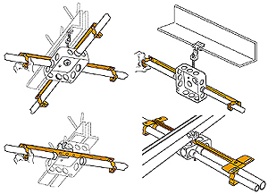

How about hanging a threaded rod with a may-west in the middle of each EMT section ?
I think that would cover support but not securing.
Bob, are you saying that you cannot hang EMT with rod and Mae West style hangers?
Hanging is not the issue. While being secured is not the same as being supported, note 300.11(A) is titled "Secured in Place". To be "secured" requires a discretionary interpretation in common language usage, and the textual elaboration of Code provides very little additional clarity.
I am saying that would constitute support, but not securing.
I don't see how you can claim it is secured in place when it can move. If the fixtures were locked in place somehow, then I would accept the idea that the EMT is both supported and secured. but hanging from a chain as the OP indicates was done, they are not "securely fastened in place" IMO as clearly required by 300.11(A).

If we can't use a Mae West to support EMT then we should tell Caddy and Minerlac to stop making them. :)
Smart $
Esteemed Member
Ohio
These are a prime example of conduit being "secured" to what they connect to.. and not the structure which supports what they connect to.
