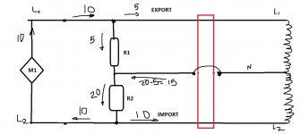

Let's say your 240V 2-wire microinverters are producing 10A on each of L1 and L2. Let's say your loads are resistive and consist of 5A connected L1-N and 20A connected L2-N.
So what are the currents passing through the meter? On L1, you have 5A from the load, less 10A from the PV, so you get -5A going into the house, or 5A going out of the house. On L2, you have 20A from the load, less 10A from the PV, so you get 10A going into the house. Then on N, you can compute it two different ways: it's either the difference of L1 and L2 at the meter, i.e. 10 - (-5) = 15A, or it's the difference in the two loads, i.e. 20 - 5 = 15A.
So how much are you going to be charged? If the L1-N voltage = L2-N voltage = 120V, then you'll be using 120V * 10A = 1200W on the L2-N, and you'll be exporting 120V * 5A = 600W on L1-N. So you're using 600W net, and if you have full net metering and maintain this situation for 100 minutes, you'll be charged for 1 kWh.

I am trying to understand how the meter will skip that reading , the energy is used on the premises , is not exported. I agreed with you it has to interact with the Utility transformer to get the neutral . could you draw on this improvised line diagram how the current flows?

Still melting my brain trying to understand the direction of the current. (I understand is AC ) I think your explanation was helpful.

Yes you're diagram is correct.
If the inverter were absent, your import would be (5A+20A)×120V=3000W
With the inverter supplying 10A, your import is 10A×120V=1200W and your export is 5A×120V=600W. Import minus export is 600W total. And the difference between load and import is 2400W which is your inverter at 10A×240V, so it checks out.
It's an important point that the meter reading may actually be the sum of imports on one leg and exports on the other. With more inverter output, you could have exports on both legs.
(I think you understand this is an extremely simplified way of looking at it, but if we properly did all the trigonometry for the AC sine waves it would also work out.)
