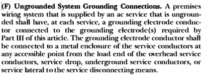

(C) Grounded Conductors. From here see 250.24 F Ungrounded system grounding connection. From here see 250.52 Grounding Electrodes

These would not be considered "service conductors" since they are downstream of utility POC. These would be considered feeders.
Also the most recent system that we are replacing and the new transformer being installed will be solidly grounded and thus require an equipment ground conductor. Perhaps original older system was ungrounded and when they more recently changed to the solidly grounded system they are using now never gave thought to the lack of EGC and have just been operating it that way.
