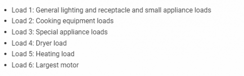

It has been a while since I've done a residential load calc and I have never done one with an EV charger.
Does the EV just get added in the special appliance calc?
I assume I would enter the sum of the EV's (in this case - 2 - 48A chargers) which would be 11,520VA *2= 23,040VA. Plus ALL other fixed appliances that would not be considered general use. Is that correct. And then apply a 75% demand factor to the total calculated load. Is that correct?
