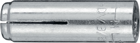

Is the difference between the two just the increased support with double expansion? Are these the preferred ones to use for trapeze racks?
If you're hanging racks from solid concrete I would not use a double expansion shield. There are better anchors that are easier to install in concrete than double expansion shields. Double expansion shields require you to drill very large holes relative to the rated size of the shield which can greatly increase your chances of hitting rebar and having to re-drill the hole.
What material is the anchor going into? It is my understanding that you use the double expansion anchors for softer materials, and the single expansion for harder materials like poured concrete.
I agree. We would reserve the use of double expansion shields for something like cinder fill concrete.
What material is the anchor going into? It is my understanding that you use the double expansion anchors for softer materials, and the single expansion for harder materials like poured concrete.Concrete deck/slab.
Concrete deck/slab. What would you use and would it change if it were a small/lightweight racks compared to a very large/heavy rack?
I would be using a drop-in type anchor in poured concrete.
Hilti drop-in anchors are wonderful. Be sure to get the pin setting tool - don't try to set them with a center punch or a screwdriver. Also, pay close attention to the load ratings, which are based partly on the PSI of the concrete they're going into. If in doubt, consult a structural engineer. Hilti also has knowledgeable application engineers, but nothing substitutes for a stamped letter/detail drawing showing anchoring especially when suspending significant loads. Look at what happened in the Boston Big Dig to see what happens when overhead suspension plans are ignored.
