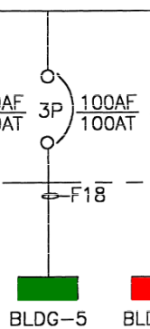

Have a unique situation where existing modular buildings( about 15) are being relocated and we need to temp them out. All I have is an existing one line showing different boards feeding the buildings to be relocated. Not all are being relocated.
If I just have below and say there are, (as an example), 15 of them like this being fed from 100A breaker that would not necessarily mean I need 1500A source of power correct? It would never demand that much at once? With the limited info I have could I just take 80% of the total amperage and say I need that much power at the source? Thanks
It's safe to assume you don't need 1500 amps but without more information it's just a SWAG.
80%, 50%, 30%, who knows.
There is no way of knowing until you get more input,,,,what are they used for ?, heat and air conditioning involved, any process equipment, etc ?

As Augie stated based on your limited information there is no way to determine what the minimum ampacity would be. Someone would need to look at the existing modular units and try to come up with a load.
When you say temped out, what do you mean? You are wiring them temporarily? Because if so, I wouldn't dwell much on the loads. Find the minimum ampacity of the HVAC unit, add 3VA per square foot for lighting and go with that. If it is for permanent, then either do a proper load calculation, or install a 30 day monitor, or possibly ask the provider of the modulars and see if they already have the load calculations.

Thanks. HVAC and lighting you mention but what about receptacles?
It's dangerous to assume anything but your lighting and receptacle loads are likely minimum. My concern would be HVAC (air c & heat) and any equipment they might power.

LOl..yes I know use of space is important. Don't know at this point.
Are the buildings in typical use?
Measure the actual load.
Get utility data for a year.
