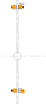

A Alwayslearningelec Senior Member Location NJ Occupation Estimator Sep 26, 2025 #1 Is there anyway you could( or would) have a common conduit down the wall for the devices back to back?
don_resqcapt19 Moderator Staff member Location Illinois Occupation retired electrician Sep 26, 2025 #2 Sure...a through the wall box, or two boxes connected using a chase nipple.
augie47 Moderator Staff member Location Tennessee Occupation State Electrical Inspector (Retired) Sep 26, 2025 #3 Google steel city CBTW-4.
