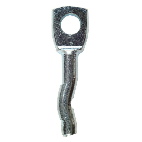

Anyone have pic of a recessed fixrture supported ot slab with chain or cieling wire? Want to see how fastended ot slab? I know it's some sort of anchor with clip or hook that the chain or ceiling wire attaches to.
We purchased ceiling wires with clips already tied that we would shoot into the slab
And for small jobs we would use something like these
