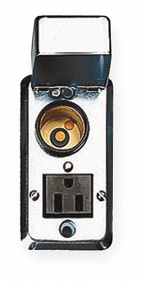

If receptacle is nessary, I would add 15A fusing or c/b upsteam of each receptacle when you tap/splice 50A branch circuit from panel.
Sent from my Nexus 5X using Tapatalk
you mean like this (but two pole)?
