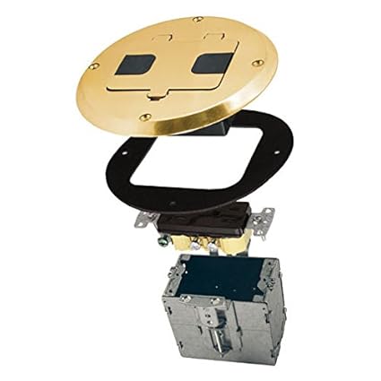

I use this box by Hubble. I like it because it sits down in the floor and the receptacle can be used with the lid closed. Lets you place a chair or sofa over it without interfering with the plug.
The cover comes in bronze and nickel/satin.

For the brass one:
HUBBELL 6239BP BRASS FLOOR BOX KIT Finish
For the nickel:
HUBBELL 6239NI
and just found out it also comes in black
[h=1]Hubbell-Raco 6239BK Floor Box Kit, Black Finish[/h]

Thanks I think I'll go with that one
