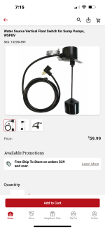

Probably the easiest way is to use a sump pump float switch. When the water level drops too low, it shuts off the pump. Since your pump is 240, the float switch has a 120 volt in/out plug, you would need a 120 volt coil on the motor controller, or cut the end off, and wire it to break one leg.

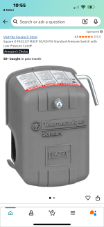

If you add a bladder tank, you can use one of these to shut the pump off if the line gets clogged or pond goes dry. It’s manual reset, but would require no control from the sprinkler system, or running wires to a float control at the pond.

I'm trying to understand this. How and where is the bladder tank (expansion tank?) placed ... require no control from the sprinkler system? I see contacts in there but I'm not getting it.
Pump is always pressurized, when sprinkler water solenoid is opened, pressure drops, pump starts rebuilding pressure. If no water is available, such as pond being dry, pressure keeps dropping until low pressure cut off is reached, and pump is locked out requiring manual reset. Kinda like hooking the sprinklers up to a city water connection.
Ok. That’s where I lost it. From what I see, the pump won’t always be pressurized.
There’s a 2” pvc pipe laying in the middle of the pond connected to the input of the motor. The pump turns on and sucks the water through it feeding to the sprinkler system.
Pump off and I think water will remain in that pipe ( or trickle back into pond ) but I don’t see how it will be pressurized.
Thank you for the help. I looked at the foot check valve. The motor is self priming but it looks like a good idea to install this foot valve.
Still the question is once this pipe is full of water how is it pressurized.
Im not a plumber, but would the bladder tank just be placed hanging underneath that feed 2” pvc pipe? Will the weight of the water laying on the bladder make and break the switch and that weight of the water laying on the bladder is “ the pressure”?
Thanks again.
You no doubt have an open discharge. That switch isn’t for you.

If it has a sprinkler control box, it turns the pump on, and opens the zone water solenoid. Thats why the bladder tank must be added for the pressure switch to work properly. If the pump output is lower than the usage, it could work, but if the output is higher, the pump would cycle quickly, eventually burning out the puno.

The system may not have one and you may not need one. The pressure tank would tee into the discharge of the pump and just sit there keeping pressure on the water lines when the pump isn't running. They are most commonly found on domestic well systems were you only need the well pump to come on when someone is taking a shower and not come on when someone is filling one glass of water.
I'm glad you mentioned "pressure". As I looked at the motor with a glass pressure gauge sticking out of the side of it, I asked my self whats going to turn this thing off if the pressure becomes to great, then back on when pressure drops, then what good would that be if the sprinkler keep turning on and off as the pump motor turns on and off?
That's what a pressure switch would be for, but you may not need one. For a sprinkler you could simply start the pump every time a sprinkler comes on and shut it off every time the sprinkler stops. Over pressure isn't much of a problem usually. If the sprinklers were clogged the pump was running it would just sit and churn inside the pump. A bigger problem is when the pump is dry and the motor keeps spinning and burns up the seal in the pump.
Would they make some type of mechanical pressure relief valve that releases pressure so the pump can keep running, and install a HIGH pressure electrical switch to cut power if the pressure goes past the mechanical high pressure switch setting?
That is what a pressure switch does. It opens when the pressure gets high enough and closes when the pressure gets low enough. As long as there is water high back pressure doesn't hurt the pump, and the motor would be happier with higher pressure than it will be with lower pressure. The pump and motor's job is to move water. More pressure in the lines means the pump has to move less water to keep them full so the motor doesn't need to work as hard.
