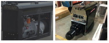

I have seen a older welder/generator that had a standard receptacle marked '115V DC'.
Lincoln SA200 "Pipeliner" They are still a highly desirable machine. This one in the vid is a 1953 "Short Hood". Having a Short Hood on a pipeline job is like having a 57 Chevy convertible. You are "The Man"
I have a "Red Face" SA200. Pretty much the same machine but with a longer enclosure. Both machines have the earlier copper wound generators and exciters. Very desirable stick welding characteristics. Smooth like silk

1960's era "Red Face"
