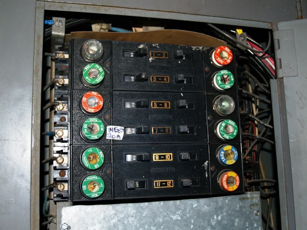

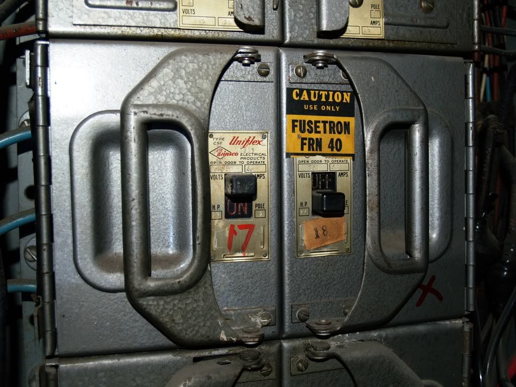

mdshunk said:
I know I didn't buy them when I was in elementary school, so they must have been available after that.
Square D QFT units were rated 100,000AIC. They were pullout design for use with type SC/Class G fuses. Each housing held (2) fuses so they actually were tandem units.
Square D also had a type QFSB which combined a type SC pullout fuse and a toggle switch for lighting panels.
The last catalogs I have seen were dated 1968. I don't know when the last "parts" were sold.
RHJohnson
Used lots of those little fuses in DCS cabinets - separately fuse outputs to field instruments, so you wouldn't blow the main fuse and shut down the power plant! Bought and installed in the late 90's, but don't remember the mfg.

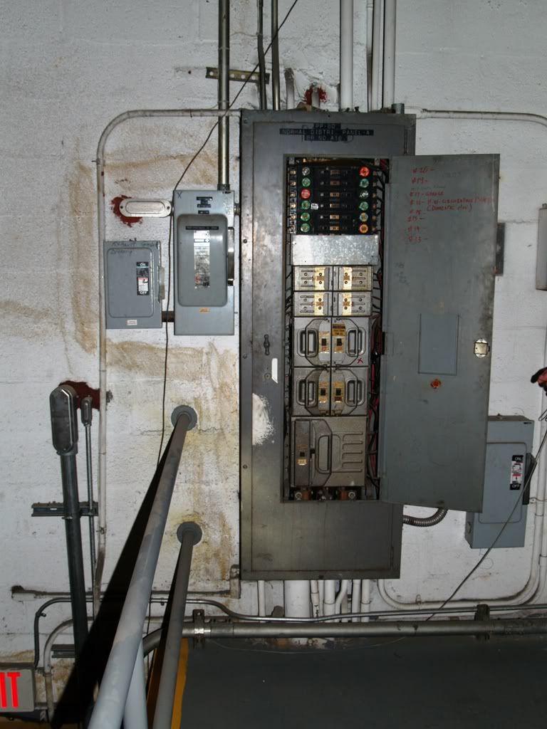

cschmid
man I think in the storage shed I might still have an old fuse panel..that has pull out main and screw in fuses..I might have to go dig around and see just to have pic of it..:grin: I have no clue as to why I would save an antique like that..I did an upgrade years back and If I remember correctly I was impressed it was in such good shape..probabully not now I don't think I have even looked at it in 10yrs..
