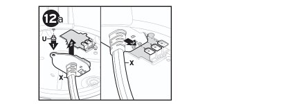

In my area they phased out hardwire long ago and now ISE is changing over to their EZ Connect Cord on the better models so that you will have to buy their cord in the future(?)
Insinkerator brand is the same way. I installed one for a friend the other day. I expected to have to swap the cord until I saw the cord that was bought with it.
