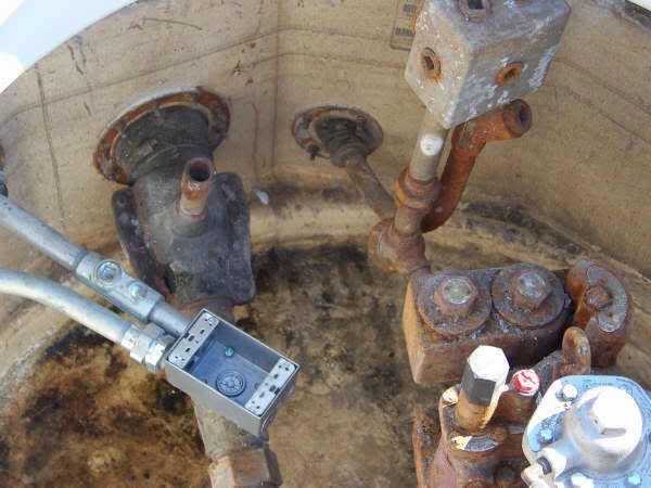

Anyone care to comment on this installations. These are for some sort of sensor at the storage tanks for a gas station.
notice the type of box. Any and all comments welcome
IN CLASS 1 DIV 1 ??? jezz i am suprised that dolt is not very bright with it from start .
bell box is not allowed in CL 1 Div 1
it should have a seal off on second box.
the other thing with bell box it will not last very long in the pit just look at other fitting you can see surface rust because with good raining day it can actally fill the pit up nice.
Merci, Marc
The bell box is for intrinscally safe wiring coming from a tank monitering system. One manufacturer of said systems will allow a flying splice with no box. See Bell boxes all the time in similar sumps. I don't use them, they don't last
Another comment, this pit( which is actually a piping sump) is not supposed to have water in it. If it does a float switch, hooked to the tank monitering system will go into alarm.

That "bell" box is a common practice for intrinscially safe circuits. It looks like there has been water accumulation in the past and someone is installing the sump sensor circuits.
I usually would try to hit a JB outside of the sumps (like at the tank level probe) and loop from that larger box to all the sumps so that only one conduit enters any one sump. It makes it easier to pull the cabling since you only have to loop through 1 box instead of 4 or 5.

I recently had to certify on this, and can share some issues with your fuel sump.
Apparantly, a tank top sump or pit is always a confined space, and requires pre-entry qualification, atmospheric tests, LOTO, Baracading, etc.. Further, with pressure regulators and relief valves clearly visible in the photo, it may be a permit required confined space meeting the potential (likelihood) to contain a hazardous atmosphere. A reference is provided: CFR 1910.146
It also appears the corrosion prevention system is not functioning, so the bottom of the tank may be worse. The most common prevention systems are described by API as Non-conductive Coatings, Cathodic Protection, or Dielectric Fittings. Electrical conduit or metal components touching the outside of metal fuel tanks can defeat a cathodic protection system.
If a permit is required locally or by OSHA 1910.146, I suspect ignoring it could be negligent. Completing this job without fixing the corrosion prevention system could also be negligent. If anything goes wrong after a contractor touches this fuel tank, and there was no confined space entry permit / pre-entry checklist record, I suspect such negligence would be liable for permitted rework, tank replacement, 3rd-party injury, or business costs.

Thats a fiberglass sump, most likely on a fiberglass tank. I doubt that any type of corrosion protection is in use

I don't see any reference to corrosion prevention for ancilliary equipment or piping, except for reference to steal tanks with sacrificial pieces of metal called anodes. If thats fiberglass I don't see any corossion requirements, unless its local, since this issue is not listed on API's published MULTI-USE PERMIT TO WORK FORM.
