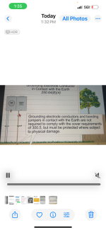

While watching a grounding and bonding video Mike said GEC is equipment grounding did he mis speak or is that only true in remote buildings where in service disconnect and or sds it would be system grounding
