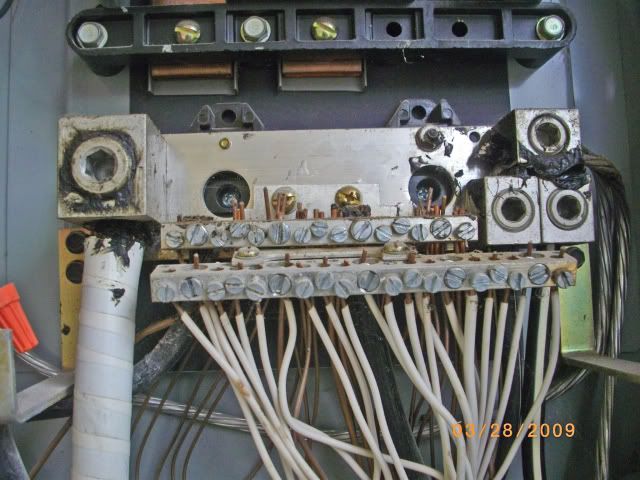

1st photo from an old home with alot of homemade wiring - not an infrared camera, just kept the flash and lights off. Who ever installed had the #14 wire connected upstream of the main breaker for the apartment (3 family home). Had to turn off all power to the building - within a minute after doing that the wire disintegrated and broke. Alot of heat damage to the terminal bar that it was connected to.

I like the single element internal panel heater installed in the first pic. Lucky they didn't burn down the building.

You realize that this could have gone much more horribly wrong?
Anything from burning inside of a wall somewhere - to say a breaker exploding in your face.
I sure did (that it why I had to change my underwear afterwards :). It is why I also shut power off to the entire home (after getting the photo) and immediately calling for assistance.
Also, there was alot of other stuff that needed immediate corrective action that the electrical contractor performed (or so I was told since then).
