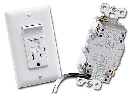

P & S & Iegrand has a miltitude of combo gfci with up to two sws and a gfci.
Now when doing box fill calcs,since the gfci is 1 sw and there is a 2nd on same yoke do we still count as 1 device or 2.
Now they also make on 1 yoke a gfci device(1) receptacle and 2 switches.Do we count thenm as 1,2 or3 devices.Who would want to make up that 3 device box ?
What device count do you use for duplex receptacles?
A duplex is two receptacles on a single yoke but it only counts as one device.
The GFCI / Switch combo is popular in this area for Hotel / Motel bathrooms.

Rules not changed.One yoke so counts as 1 device.Depending on cost i see it as very usefull.

I had to use one of them once, but I forget the exact reason. It runs in my mind that they were about 40 bucks, wholesale. Not something I'd use without some other overwhelming reason.
