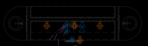

I run into this often. The receptacle is within 6 feet of a sink but there is a wall separating the receptacle from the sink. Does the GFCI rule still apply?
For the drawing you gave, put the dang GFCI in and be gone.
or Dual function everything, which sounds like the trend and makes sense unless you are looking to be the absolute bottom dollar on each project.
