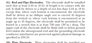

I used some 3/4" galvanized heavy wall conduit back in the 1970's for ground rods. Usually had to get out my heavier 20 # sledge hammer to drive in the last few feet. Now with a ground rod attachment for larger hammer drills to drive in 5/8" ground rods fairly fast that is they only way to go. While at one of the big box store recently to get some Christmas tools mean gifts saw a ground rod driver for hammer drills that only cost a little over $40.
But how do you pound in a 3/4” galvanized EMT with thinner walls as you would a 1/2” rod?
But couldn’t you use emt if you had a hole dug 10 feet?

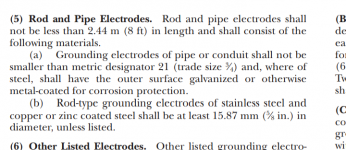

Let me go read that section. Driven comes to mind. However that may not be the wording.
3/4 galvanized EMT may be applicable. I'll go read it.
After all water pipe is laid in a trench.
I'm thinking this is where the pipe electrode came from.
I'll get back to you. Thanks
No, because EMT technically isn't conduit or pipe.

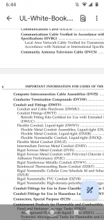

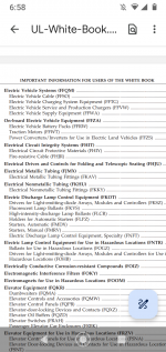

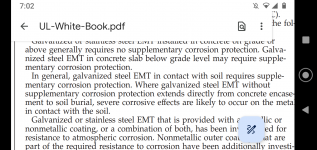

I wanted to add. From UL white book.
EMT (tubing)
Even if galvanized, UL requires additional protection if in Direct contact with earth. This would defeat the purpose of using it as an electrode.
So I would say it shall not be used.
UL has section for conduit and for tubing. NEC also uses this language. Ok to slang it as long as we know the difference. Some will argue however I'm ok with it as long as we're not teaching or testing.
This is one of those case the word conduit matters.
