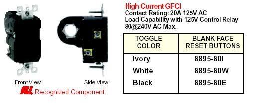

I've seen GFP devices with a big coil on the back that you route a conductor through. These were 6 and 30ma devices. Never saw a 10. Sounds European.
I'd be very curious to see a GFP device that has a designed connection for reading the EGC. I agree with your take on it, Bob, the GFP would be all but worthless if it didn't react to current travelling on the EGC as well as current simply escaping into the earth (or water).
Marc, do you have a link to the thing you're thinking of?
Yeah, let me dig it up. I posted about it years ago... hang on...
Well, it's not quite as I remembered, but here it is just the same:
Thats a new one on me. There are so many devices made I don't think one person could possibly know of them all.
