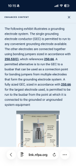

the CEE he is referring to is a Concrete Encased Electrode. yes, a UFER. and if you have one, you're good. you do not need a rod. ActionDave has the picture out of the handbook, referencing GEC systems.

If I understand your question correctly, one GEC back to the panel is enough.
There is only one grounding electrode system. It is made up of all available electrodes present at the building. If there are no grounding electrodes present you make your own. Driving two ground rods is the easiest way to do that. (You could make your CCE or trench around the whole building and install a ground ring.) All grounding electrodes present are connected by bonding jumpers and one Grounding Electrode Conductor can be brought back to the panel. Sizing rules and ease of routing may make running another GEC from the panel to a GE desirable, but it's not required.
250.50, 250.52 talks about grounding electrode systems. 250.53(C) talks about bonding jumpers. That takes you to 250.64 where it talks about grounding electrode conductors. The definition for bonding jumper is in Art 100.
I was looking for the reference for the MBJ being a screw/strap then the GEC being with the neutral bar- also thank you all for the help! I was able to find the answer black and white right in the code! I posted a photo with a description to someone else’s posted illustration
