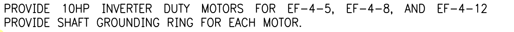

Thanks. Link not working. Would that be done by the electrician?Shaft grounding rings are installed on the shafts of VFD driven motors to prevent current damage to the bearings.
It should be working nowThanks. Link not working. Would that be done by the electrician?
