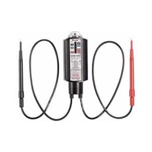

I was asked to check if a bedrooms receptacles had proper grounded. My 3 pronged plug in tester showed 2 amber lights indicating the receptacle was wired correctly. I then did a fallow up test checking voltage across hot and neutral. It read ~120 volts. Next, I read across hot and ground. It read 87 volts.
I've not seen this before. How can it be explained?
Bad or no real ground. Try reading the voltage with some sort of load on it, like a Wiggy:
My guess is that it is not really grounded, the grounding conductor is open and all you are reading is phantom voltage.
I got the 87v using a Fluke. What would a Wiggy tell me that my Fluke would not?
It would put a enough load on the circuit to eliminate any phantom voltage readings. It would be even better if you used both your fluke and wiggy at the same time.
If the 87 volts stayed rock solid I would look for a poor connection, if the 87 volts fell to zero I would look for an open connection.
Am I correct then in assuming that this wiggy is what the NEMA article refers to as "low impedance" test equipment? Makes a lot of sense that it would. I want one now, I guess I just always assumed they were a poor-man's analog volt meter (Which there's nothing wrong with, if you're broke like me!):thumbsup:

On 120V circuits you can use any wattage incandescent light bulb with pig tails as your tester. If the bulb lights (even dimly) it is real voltage (bad ground.) If it doesn't it is phantom (induced) voltage and will go to zero (no ground.)
The typical Fluke meter on V scale has 10 meggohms input impedance.
I measured around 3K ohms DC resistance on my Knopp wiggy and 12 ohms on a 75W bulb, so there is the difference.

Some digital meters have a 'low Z' setting which puts enough load on the tested circuit to eliminate 'phantom voltage'. They draw enough current to trip GFCI's which can be handy for checking the GFCI.
