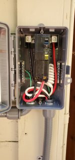

Had a customer ask about a hot tub that didn't have a neutral and he stated that the hot tub company installed the wire and told him all he needed was 2 hots and a ground so that's all he ran. I told him to cap the neutral off in the spa box but he said the GFCI wouldn't trip with the text button and then he installed the neutral wire with the ground wire and it would trip when hitting the test button. I told him to check with the Hot tub company to make sure it didn't need a neutral but the GFCI breaker should trip with the test button with the neutral capped off, correct?
Where is the GFCI in the circuit? A GFCI breaker needs a line neutral but not a load neutral. Without a line neutral its just a standard breaker (no GFCI protection)
My understanding is he was told it just needed a 3 wire setup and that's what he ran. He stated the hot tub company terminated the wires in the hot tub so I believe he installed the hot tub disconnect and ran his wire from the panel to the disconnect . The disconnect is splicing the wires from the panel and the hot tub. Test button wouldn't work until he terminated the disconnect neutral pigtail to the ground in the disconnect.
Assuming the hot tub disconnect has the GFCI he needs a 4-wire feed to the disconnect. If the hot tub only requires 240 he only needs 2 hots and an EGC from the disconnect to the hot tub.
Move the GFCI breaker to the main panel and then put a switch only breaker or non-GFCI breaker in the disconnect box. The GFCI will protect the wires up to the disconnect and after. LOAD side neutral shouldn't be needed with a GFCI, but you need a line side connection. If this circuit to the disconnect is very long, you may get nuisance GFCI tripping.
I believe that's what he has. The hot tub company should have never told him to just run the 3 wire set-up. I asked him how long the run is and if he can run a new 4 wire to the disconnect, but haven't heard back yet.
He was telling me that he couldn't get a GFCI breaker in his sub-panel for some reason. Not sure what sub-panel he has as I haven't been to the location. Looks like his best option is to run a new 4 wire to the disconnect if possible.

So this is what he is telling me. His sub-panel is a Homeline and they dont make a 60 amp GFCI breaker for that panel for some reason. The company told him he needed a 60 amp and not a 50 amp because of dual motors or something like that. His run is 70 feet of 6/2 so I suggested to him to relocate the spa box with the GFCI breaker in it beside of the sub-panel and run a short piece of 4 conductor wire frome the sub-panel to the spa box and keep the existing 3 conductor wire in place and put a non-GFCI disconnect near the hot tub.

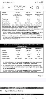

I'd be verifying actual loads in the spa and see if a Homeline 50 amp GFCI would still suffice. Pumps generally are all about the same in most units, heater wattage might be one the bigger variances. Many spa control panels are one size fits many models so you can't go off the control panel itself. Often they don't even have all possible features being utilized.
FWIW, QO260GFI breakers do not have a load side neutral terminal. They still need a supply side neutral to run the electronic components though.
I suggested a 50 amp to him but he said the company told him he needed the 60 amp because of dual motors or something. I haven't seen the hot tub so I don't know the specs on it, just going by what's he's telling me.
If larger motors and possibly even a larger heater I could see 60 amp breaker being necessary. 50 amp breaker maybe even 40 amp breaker would hold running current on most units, but possibly may need a little higher setting to allow for motor starting? Heat won't ever be on (without malfunction) if heating circuit pump isn't proven to have pressure or flow so that helps with the starting surge and possible breaker tripping.
This is what he sent me so I guess there were a few options. Screenshot_20250626_083928_Chrome.jpg
Makes sense, but at same time a 50 amp breaker should hold indefinitely on a 45 amp load. As I said before the heater will not be running when the heat circuit pump is starting so that helps allowing it hold when pump is starting.
