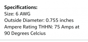

I don't see anything larger than the 3/8" Bridgeport double-snap, and that's too small for 6/2MC. Any ideas?
Thanks!
Try and imagine how big that connector would have to be. What size box are you using? You will never be compliant with 2- 6/2 mc cables and a device.
Tell us more what you are doing.
You will need to get a connector based on the OD of the cable.
An example would be 6-2 g mc
OD= .755. find a connector for mc that has a range to which this fits.

I'd use old work without clamps and use 3/4 MC connector. not a a queeze but double screw clamp. These larger wire MC can be very small
