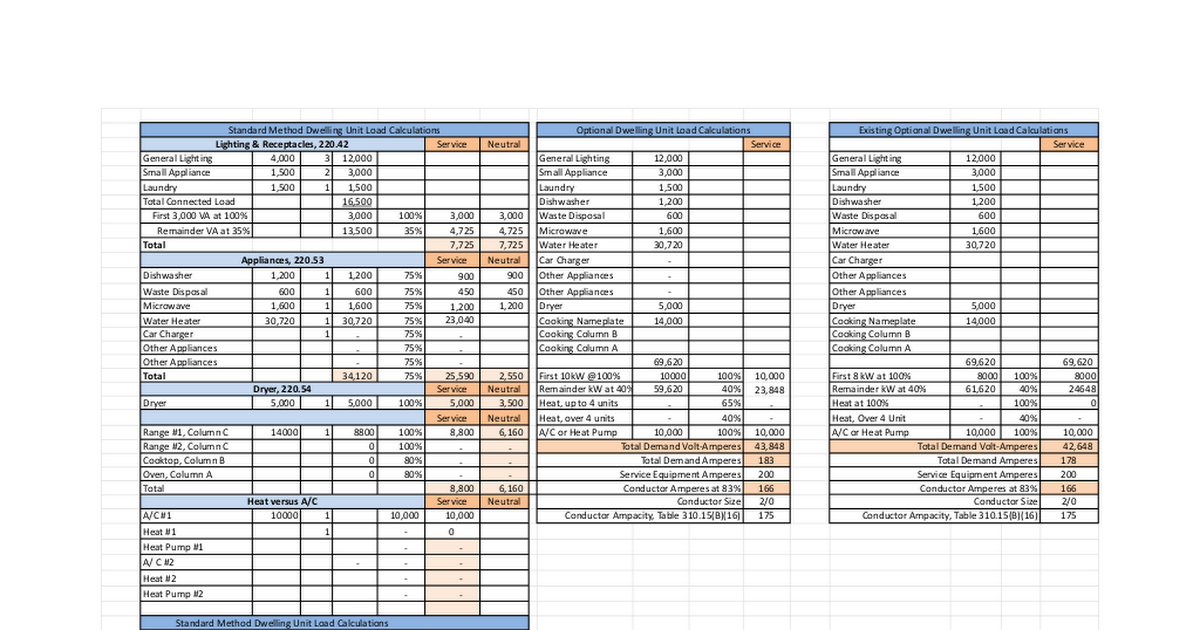

How to calculates total service demand load for a restaurant when I have high leg service and a mix of 3phase and 1phase loads?
Volt-Amps
Indianapolis
Do I calculate 3 phase loads separate from 1 phase loads then sum up the two on the 3 phase high leg service?
I'm thinking:
  • For 3 phase 120/240V panels having mostly 3 phase and 1 phase 240V loads: ( total KVA on panel x 1000) ÷ (240 x √3)
  • For 1 phase 120/240V panels having 1 phase 120V loads: ( total KVA on panel x 1000) ÷ (240)
Then sum up the two and that would be the total demand on the building service.
Could you gurus chime in and help stop me if I'm doing it wrong?
Thanks much
I treat a 'high leg service' by that I mean utility supplied 240/120V open delta with two pole mounted transformers different than a full delta with a common core or a padmount with triplex cores or three pole mounted transformers in a delta (3 equal kVA ratings).
The open delta has a split phase 120/240 transformer (lighter) and a single phase 240 transformer (stinger) and they may be of unequal rating.
The simplest method with open delta is to tabulate the pure 3-phase 240 loads and the 120/240 or 240 single phase loads separately.
If you can know for sure which set of wires is on the '240' stinger transformer (not the open jaw) you can 'top it off', with single phase 240 loads, if you put any 240 single phase loads on the 'open jaw' (or the wild leg to neutral) it would pull from both transformers.
