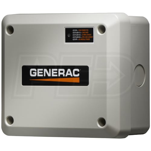

What is this anyway? :) Looks like it limits to 50A, single phase circuit.
It's nothing but a wireless relay. There are many options and configurations. it's controlled by load management software which talks to the generator. Not sure what generator you have...
