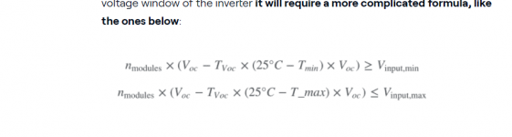

i want to do string calculation but issue is that from where we can take Tmin and Tmax temperature of our site
also i add equations

You need to find some historical temperature data for the area of the PV site. We have decent access to that in the USA, I'm not sure what would be available in Pakistan.
