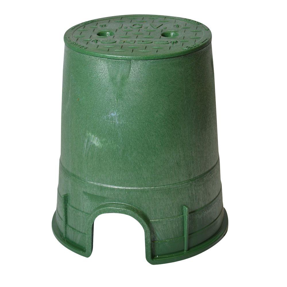

I have a 1" PVC pipe coming straight up out of the ground at the top of a retaining wall in a customer's backyard. This was installed for future use by the previous owner when they had the retaining wall and paver patio installed. The other end of the 1" pipe comes up right net to the house.
So from the end of the pipe at the top of the retaining wall I need to trench about 15' to a new garage they are having installed. I would prefer to box it where the pipe currently ends since I don't know how many bends are made to get it there. This is near a fence so I could just drive a post into the ground to attach a PVC box to and bring the conduit directly into the bottom. But I was wondering if someone had another suggestion? The owner doesn't care what it looks like, but I would rather have it neat if I could.
