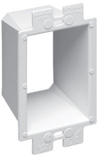

Bring some long #6 screws in case the ones that come with it don't reach.
With one of these sandwiched in there, if needed:
And some silicone if the gasket isn't good enough.
