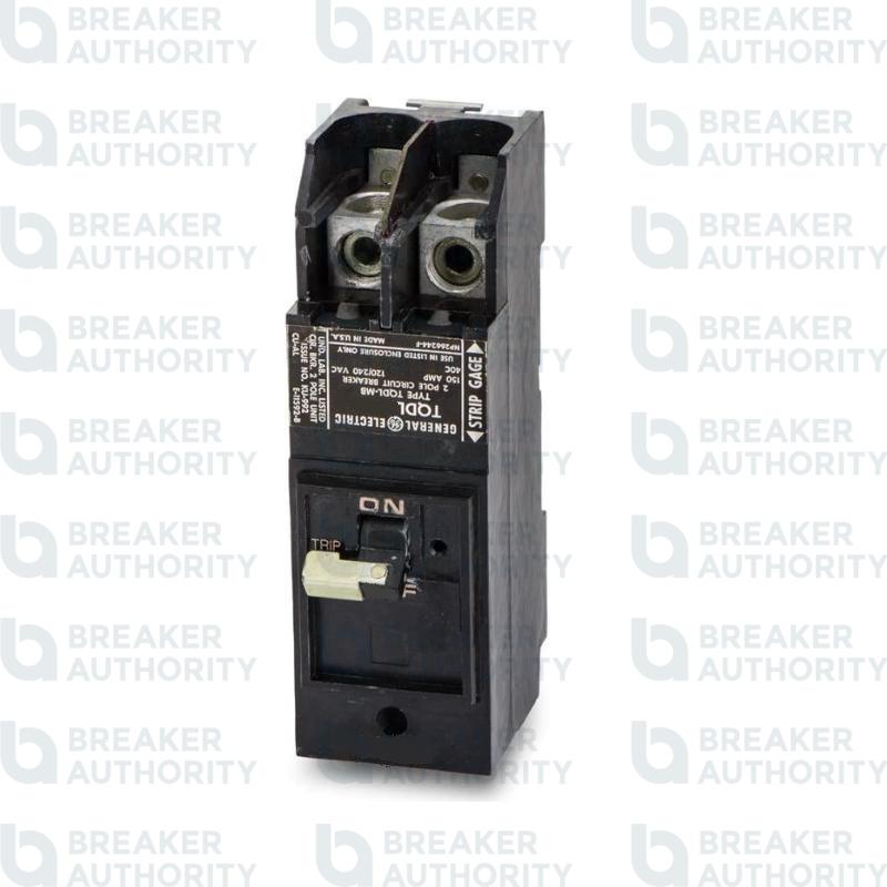

Hello gents, wondering if anyone could steer me in the right direction with finding a part. Working at a mobile home park in Newport News VA and came across a bad GE TQDL21200 main disconnect breaker. Doing a little bit of research and putting in some common sense I’ve come to the conclusion that this breaker is very old and obsolete… So next thought is swapping the enclosure, which is a meter base+main disconnect combo on a pedestal. For some reason I cannot find an enclosure that’ll work as a replacement, all I can find is meter+main disco outdoor panels. Anyone care to chime in and shed some insight? (200A single phase underground service)

My first recommendation would be to reach out to your local GE rep and ask them about a replacement. If you don’t know who to call, I don’t mind texting my GE rep tomorrow and asking.
My second suggestion would to be that you just replace that disconnect with something off the shelf. It would require re-working that feeder into a new enclosure but probably could be done faster than trying to find the breaker.

For the amount of labor a direct breaker swap would save compared to an enclosure swap out seems well worth the money in my opinion. That re-certified unit from breaker authority isn't too bad actually, and with a two year warranty that might actually be the move. Will present that option to the boss on Monday! Thanks for the time Fred!

Fred B sent a few links to breakers up above, but if my boss doesn't want to deal with third party retailers and wants to go directly through GE (If we don't go the route of swapping enclosures) then i'll totally let you know dude! Thanks!

That was just 5 minutes online search, probably others out there also. AFA being 3rd party retailers, most supply houses are that, almost never get things direct from factory, they'll just tell you the authorized retailers.
Haven't ever used a recertified breaker, maybe some can speak to the quality and reliability. But can they be much worse than some of the stuff coming out of the factories recently, QC is very hit and miss.
