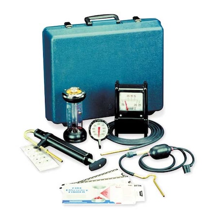

MA is one such state that licenses every trade. If you remember Steve L the YouTube plumber (we posted his famous toilet unclogging video awhile back). He's also a licensed HVAC and gas tech and has many videos of his work on gas and oil-fired equipment. With gas, he is required to test the CO in the stack which must be 50ppm or lower and if it can't be adjusted or repaired to produce that he red tags it. Testing the CO is the way to determine if a burner is burning properly- after visually looking at it.
When I was doing oil (mostly my own) years ago I still have an old Bacharach kit that tested CO with a liquid that had to be replaced all the time. Looks like it's still available-
Of course, today there are better ways for about the same price-
